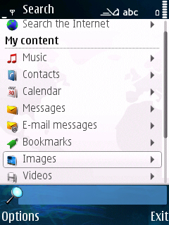

Nope, it works just fine on my N95. In fact, I'm mighty impressed by it. Love the way it allows me to search the internet or various aspects of my N95's content.
Attachments: Screenshot0002.jpg
It's ok except it searches yahoo and Live... I'd rather load up the web browser and use google
