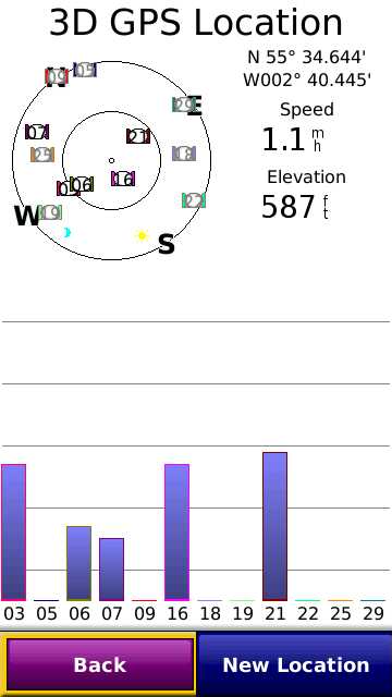

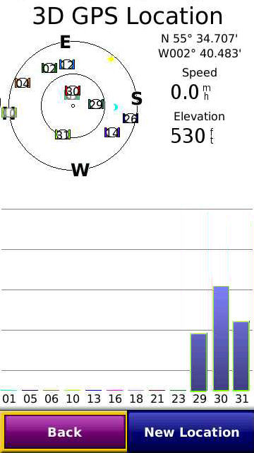

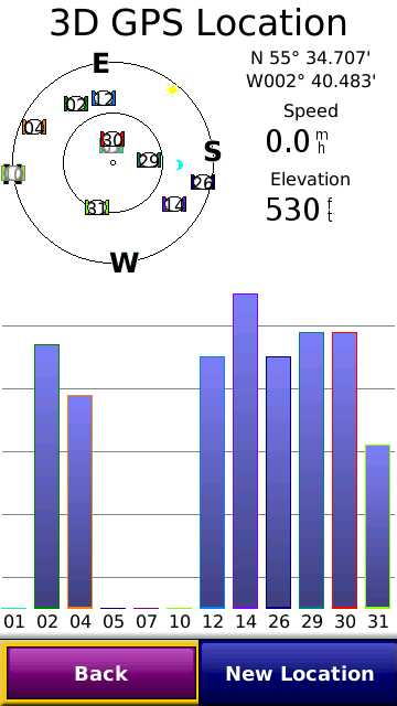

See 3 images below or reception when... Faulty, Fixed (outdoors), and Fixed (indoors)
Attachments: GPS Faulty.jpg GPS Repaired.jpg GPS Indoors.jpg
Wow Dez, that seems like a huge improvement there.. I did not see these graphs side by side yet, so now I really need to take my faulty version to the Care Center soon. The problem is that these centers are only open during office hours, so I need to find some time to drop it off there (as I tend to be working during office hours as well).. Good to see that things are indeed fixed. I almost wanted to order me a new one, but I was afraid that the web shops would be dumping the 'old' versions first...
