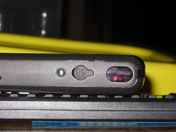

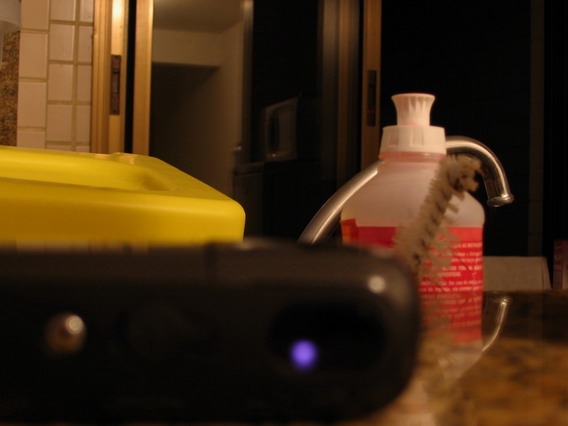

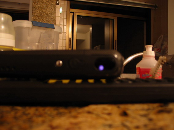

Took some pics, it is kind of tricky since the red shining "LED" turns out to blue when photgraphing it with a Digi Cam, but you can get an idea, how strong it lights.

cwoern wrote:Hi Kevin,I assumed there is no "standard LED" behind the window, what for? So it seems it's the IR which is lightening so strong?
