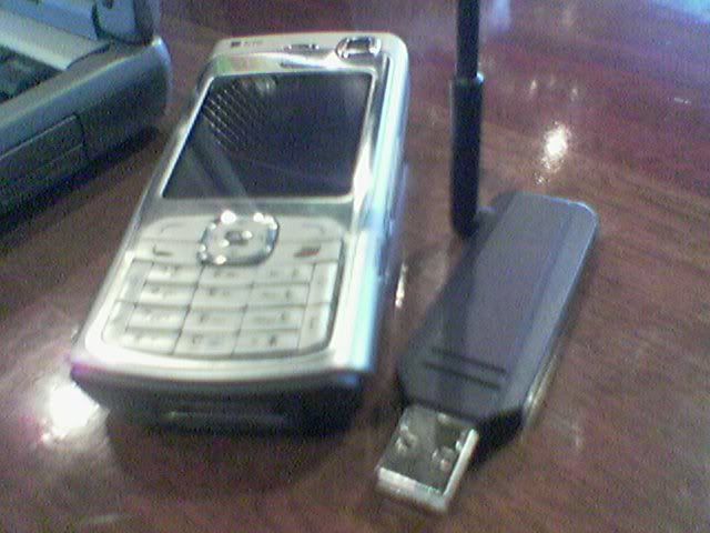

messus wrote:You're indicating what?
My max BT speed capability via BT connection to n70 using a Class 1 BT 2.0 dongle.
EinZtein wrote:My max BT speed capability via BT connection to n70 using a Class 1 BT 2.0 dongle.
you're sure it's 2.0? the only 2.0 dongle to my knowledge is the "trust BT-2200TP", and i believe it just hit the market. just to be sure...
LosOutlandos wrote:you're sure it's 2.0? the only 2.0 dongle to my knowledge is the "trust BT-2200TP", and i believe it just hit the market. just to be sure...
Quite a few of the new Sony notebooks have BT2.0 built-in. I have got a TX17 (sweet machine) but haven't got my N70 yet so can't test. How about someone here send me their N70 and I can test for you guys.........😃
And no, I am not going to send you my TX17 so that you can test.....:tongue:
mlai wrote:Quite a few of the new Sony notebooks have BT2.0 built-in.
didn't know that! at any rate, i checked wikipedia and it seems bt1.2 only goes up to 723.1 kbit, so it seems EinZtein has already proven it's version 2.0! :icon14:
quote from wikipedia: "Implementations with versions 1.1 and 1.2 reach speeds of 723.1 kbit/s. Version 2.0 implementations feature Bluetooth Enhanced Data Rate (EDR), and thus reach 2.1 Mbit/s."
LosOutlandos wrote:didn't know that! at any rate, i checked wikipedia and it seems bt1.2 only goes up to 723.1 kbit, so it seems EinZtein has already proven it's version 2.0! :icon14:
And I envy EinZtein..... He either has a super cheap data plan or a really fat wallet....... Look at the amount of data transfered......
Yeah, CompUSA branded the the first ones that came out. It's so fresh it doesn't even have any logo info on it yet! It's supposed to be covered in CompUSA and Bluetooth logos, which looked kinda cool. But now I can tell the dumb people that 's my wireless internet access dongle.lol
I have the MS bt keyboard and mouse which came with a 2.0 dongle just to let you know and I have to say I can't do two bt things at once with my phone, highly annoying!!
mlai wrote:And I envy EinZtein..... He either has a super cheap data plan or a really fat wallet....... Look at the amount of data transfered......
Yup, unbelievable, I've got an old TMobileVPN data plan, $19.99us a month un-limited.😉 :icon14:
I've racked up almost 1gb of data since I got this n70!😮 😮 😮
The Tmo edge speeds have been impressive in the Detroit area too! 😃
