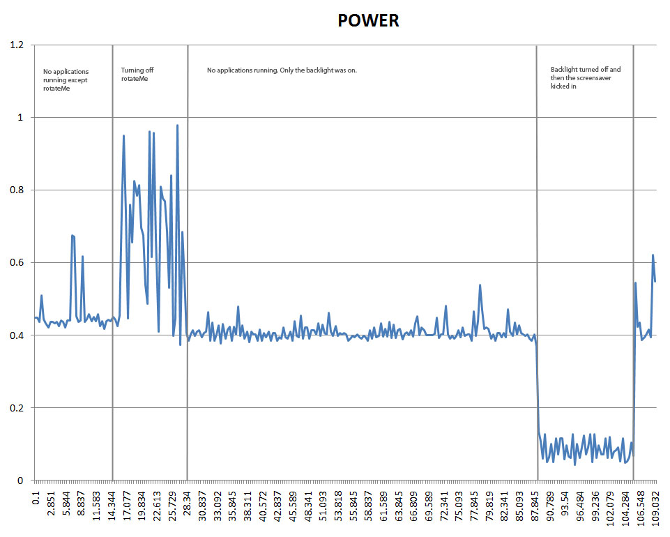

This thread got me thinking about power consumption on the N95-1 after the upgrade to v21.0.016. I decided to take a look myself.
I've attached a line graph of my results. The horizontal axis shows the timestamp and the vertical axis shows the power used. I have also labelled on the graph what was happening at different timeframes.
The part to pay most attention to, I think, is the bit when the backlight turns off and the screensaver kicks in. You can see that the power level is at ~0.1 - I'm not sure if this is better than before with v20.0.015 but I thought it might be useful for some people to know if they're having battery life problems and are upgrading to the newest firmware.
